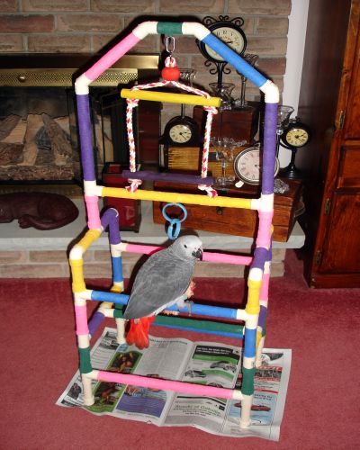

This is the first attempt at building a playstand. Mika loves it.(but may need sunglasses)
This is also the first attempt to add a pic so please be patient if it doesn't work :unsure:
Carolyn Mika_Send.jpg<br><br>Post edited by: Carolyn, at: 2008/07/25 12:58

How did you attach the swing to the top bar? I've built a few real simple stands, but nothing like this. Quite a good job you did!

Did you use PVC glue, or just push them in hard? I worry about PVC glue around Gandalf, but .. I guess I could do it outside. He loves watching me while I'm building one. I haven't glued any of mine together yet -- it also lets me pull them apart and put them together in a different format if need be.
I'd be curious how it works out long-term. Gandalf loves chewing off the Vetrap tape that I've used. He hasn't liked different levels, so I haven't tried a multi-level one like this.

Can you post a full-size pic so I can look at it in more detail? When reduced to fit this forum you can't look at details -- what kind of connection is at the bottom; how the blue circles are attached; etc. Don't know how to get you my email address if you simply want to email it to me..

Does Mika get up on the top perch at all? I'd presume so, since greys love height, just curious how much time s/he spends up there.<br><br>Post edited by: n2fisher, at: 2008/07/26 19:07

You won't believe how much showing your playstand helped me out. I just bought a large playstand and it has 5 perches going up to the top food area. The perches are pvc and I'm was trying to get him used to it but he really hasn't looked all that comfy on it yet. He more or less just tolerates it :angry: and I figured I wouldn't be using it much. Then I seen the vet wrap on yours and the light bulb went off in my head.:ohmy: I bet with the vet wrap he will feel much more safe & secure. No wonder why he isn't taking to it. The plain pvc is probably scary to him since he can't grip it real good. Thanks for showing it. Now I know what I have to do. Thanks again!!!:woohoo:
