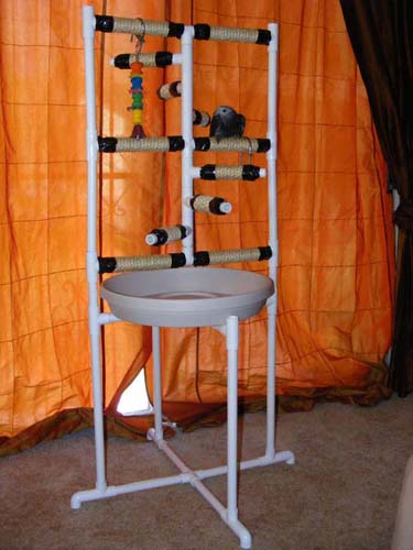

cdelatorrejr Posted July 22, 2008 Share Posted July 22, 2008 Here's a playstand I built this weekend. I posted it on another thread also. It took me about 5 hours in total and the cost was roughly $50.00. I wanted a playstand fun enough and functional without a large footprint. I took concepts from stands I have seen and merged them together. Its constructed from a plant saucer, PVC piping, various PVC joints and natural sisal rope. My baby TAG, Bobot, is still getting used to the various perches at different heights but is showing interest. Link to comment Share on other sites More sharing options...
Lauri Posted July 23, 2008 Share Posted July 23, 2008 I love the playstand! Can you please tell me what the black things are holding the sisal rope down? Vet wrap? Thanks! Link to comment Share on other sites More sharing options...

cdelatorrejr Posted July 23, 2008 Share Posted July 23, 2008 Lauri: I didn't want to use any epoxy since they are toxic to our feathered friends so I opted on using an adhesive tape - Gorilla tape. Its advertised as the strongest. My baby TAG, Bobot, is starting to pick at it and its holding up fine for now. Link to comment Share on other sites More sharing options...
Lauri Posted July 23, 2008 Share Posted July 23, 2008 cdelatorrejr: I've never heard of Gorilla tape....glue yes, but not the tape. Very interesting I went on their site and MSDS states that it's not toxic. My first concern was the toxicity when I read "Gorilla" since I know the glue is very toxic. Hmmmmmm I'll have to look in to finding some tape. I've used vet wrap in the past and my Macaw made short work of pulling it off. Thanks!!!! Link to comment Share on other sites More sharing options...
cdelatorrejr Posted July 23, 2008 Share Posted July 23, 2008 I found it reasonably priced at Home Depot. Good luck! Link to comment Share on other sites More sharing options...
