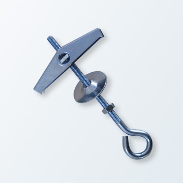

SRSeedBurners Posted June 24, 2013 Posted June 24, 2013 (edited) Dan's solution won't fall out if you're going straight into a ceiling joist. If not use a toggle bolt. If you have access to the ceiling, drill only a hole large enough for the bolt to pass through. Screw the toggle on when you're inside the ceiling. These usually require a hole large enough for the whole toggle to pass through but with ceiling access, you can make a tiny hole and get away with that. Edited June 24, 2013 by SterlingSL

danmcq Posted June 25, 2013 Posted June 25, 2013 ASterling is spot on. It the eye hook must be sized according to the size and weight of what your going to hang. I have small eye hooks for bongs and large anchored eye hooks for a hanging play stand that weighs around 25 pounds. 1
