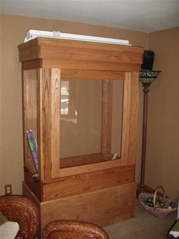

dibblm Posted February 9, 2009 Share Posted February 9, 2009 Well it's almost done. The SS mesh I order was wrong and I am still waiting on replacements for that but for the meantime, I thought I would share with others what they too can build for 1/3 of whats being asked on the Internet. I still need another coat of stain on base. The light needs recessed yet. And locks and a door handle. If anyone needs custom plans made or if you want the plans to make one like this yourself, I would be happy to make any size drawing you like so you can build one yourself. Post edited by: dibblm, at: 2009/02/09 00:41 Post edited by: dibblm, at: 2009/02/09 00:43<br><br>Post edited by: dibblm, at: 2009/02/09 00:43 Link to comment Share on other sites More sharing options...
rierie Posted February 9, 2009 Share Posted February 9, 2009 That is really pretty. I love oak.. Link to comment Share on other sites More sharing options...
danmcq Posted February 9, 2009 Share Posted February 9, 2009 Wow! Very nice. Thanks for sharing this photo. :-) Link to comment Share on other sites More sharing options...
judygram Posted February 9, 2009 Share Posted February 9, 2009 That is a very nice looking bird cage, it looks almost too pretty to put a bird in, thanks for sharing a pic of it with us, would be interested in seeing the final product when finished. Link to comment Share on other sites More sharing options...

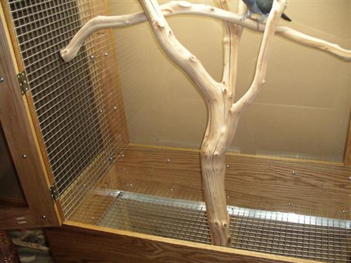

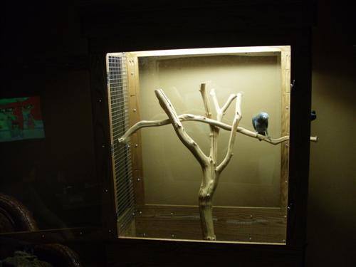

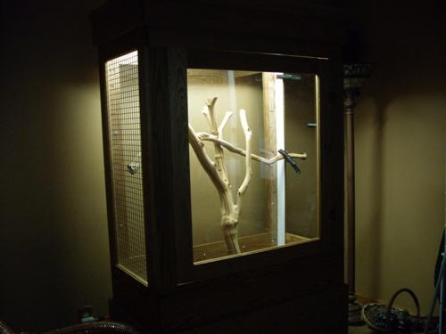

dibblm Posted February 13, 2009 Author Share Posted February 13, 2009 Posted a couple new pictures. Almost done. <br><br>Post edited by: dibblm, at: 2009/02/12 23:22 Link to comment Share on other sites More sharing options...
dibblm Posted February 13, 2009 Author Share Posted February 13, 2009 1. <br><br>Post edited by: dibblm, at: 2009/02/12 23:23 Link to comment Share on other sites More sharing options...
dibblm Posted February 13, 2009 Author Share Posted February 13, 2009 one more. Link to comment Share on other sites More sharing options...
judygram Posted February 13, 2009 Share Posted February 13, 2009 Thats going to be a really nice looking bird cage and your grey already likes it,so when will it be finished? Link to comment Share on other sites More sharing options...
Luvparrots Posted February 13, 2009 Share Posted February 13, 2009 Gorgeous handmade cage. You do lovely work, thanks for sharing your masterpiece. You grey must definitely love it. Link to comment Share on other sites More sharing options...
dibblm Posted February 13, 2009 Author Share Posted February 13, 2009 Hoping to finish this weekend. Had a hold up on the wire mesh I ordered. First order wasn't what I ordered so I had to wait for replacmeents. Lets see: Whats left to finish. Still need to fabricate the plexiglass layer on the right hand side. Mesh the Right and top. Build a waste tray and a sliding shelf for the food. Then fill with LOTS>>>> of toys... Link to comment Share on other sites More sharing options...

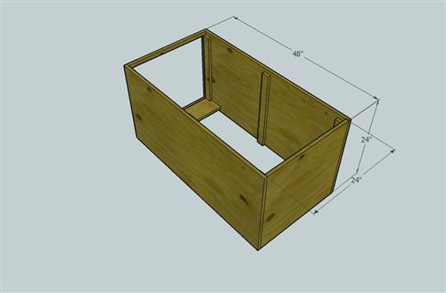

dibblm Posted February 23, 2009 Author Share Posted February 23, 2009 I decided to make some drawings based on my scale. The first is the base. Base Dimensions are : Length: 48" Depth: 24" Height 24" What Im basically trying to show here is how the cage sits in the base. Just resting on the 1 X 2 verticals. The lower braces you see are for the casters and the opening is access to the lower grate, cleanout tray, and storage shelf. This is where I made the mistake. The wife wanted the opening here till we got it into place. Once in place she wished I would have made it in the front with 3 seperate doors to open. I agree and wish myself thats the way i would have designed it. Post edited by: dibblm, at: 2009/02/23 02:44<br><br>Post edited by: dibblm, at: 2009/02/23 02:45 Link to comment Share on other sites More sharing options...
dibblm Posted February 23, 2009 Author Share Posted February 23, 2009 base Link to comment Share on other sites More sharing options...

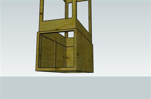

dibblm Posted February 23, 2009 Author Share Posted February 23, 2009 Here's the middle section Link to comment Share on other sites More sharing options...
