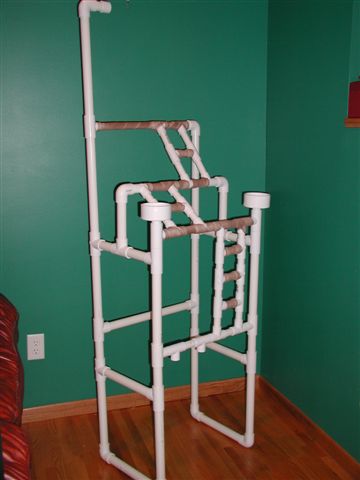

LisaM Posted November 4, 2007 Posted November 4, 2007 As if I didn't have enough excuses to avoid cleaning the house, today my daughter and I bought about $30 worth of PVC and built this play stand (I did draw it out and have a plan ahead of time). Total height is 72" (top perch is 52"). Top bar will have a hook for toys and I'm thinking of changing out one of the connectors on the right for another hanging toy once they get used to the new stand. There will also be another ladder going to the floor so they can easily climb back onto the playstand. I wrapped the perches and ladder steps with tan Vetwrap. Now I just have to get the little buggers to not be afraid of it...They won't go near it. I'll give them awhile of just seeing it across the room. Thanks to you on this forum who have posted pics of yours you've built (and of course you, Joe, who is the master of playstands!). I'd never worked with PVC before, nor had I thought to try to make my own playstand before joining this site! Lisa

LisaM Posted November 4, 2007 Author Posted November 4, 2007 Thanks guys! Anyone know what will take the printing off the outside of the pipes? I tried a ton of stuff we have around the house and nothing worked. Lisa
WonderMomma Posted November 7, 2007 Posted November 7, 2007 Lisa, I have sanded the pipes down to get this stuff off... plus, sanding usually gives the birds a better grip too so you don't always have to use vet wrap. :-) The rougher the sandpaper you use the better. Just be sure to clean the pipes thoroughly to remove loose pieces. Very nice stand you made there, I'm trying to get ideas to make one myself.

LisaM Posted November 18, 2007 Author Posted November 18, 2007 Hi all - thanks for the suggestions. I did try one of the Mr. Clean magic sponges and it didn't work (I was actually surprised because those babies seem to work on EVERYTHING!) They do sell a PVC cleaner I guess and I bought some but it is pretty strong so I don't want to use it for fear of not being able to wash it off enough. WonderMomma - I was concerned that sanding it might make it harder to clean in the future? Do you find that it still cleans up nicely when sanded? I have been drawing up several other "designs"...and looking into investing in a table saw or something better to cut it with and that part was the biggest pain. Thanks again, Lisa

LisaM Posted February 14, 2009 Author Posted February 14, 2009 Hi Deanna - yes, the feeders are 4" endcaps. The only glue I used on this entire thing was to glue little 1" pieces on the underside of the endcaps so that they would sit in a 1 1/2" tube (for stability. I let them air out for over a week in the garage before bringing them into the house. I also didn't bother cleaning off the stamping/printing as it was only on the legs of the stand (where my birds won't go) and I figured the stuff you use to remove it was pretty strong. The pieces themselves fit together very tightly. In fact, it was very difficult to take this apart when I wanted to. It was very stable even without the glue. An alternative to vetwrap is using a small safe rope and wrapping it around. I always meant to do that but never did.

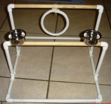

ranaz Posted February 17, 2009 Posted February 17, 2009 HI I am working on a small stand for my bird, with the same material, but in order not to take any risk with PVC, I am wrapping the whole thing with a small cotton rope (3mm). It takes a lot of time but at least I know bird has better grip, can climb on it and it hides away the PVC. Once I complete each stick, I stick the end under the plastic connector and it holds pretty stongly. I will wash the rope wrapped plastic bar with disinfectant that is bird safe and let it dry out in the sun for a while... Lisa...lovely idea...If you get to graw other designs please share with us...Thanks a lot Rana{Nature-00020097}<br><br>Post edited by: ranaz, at: 2009/03/21 12:25

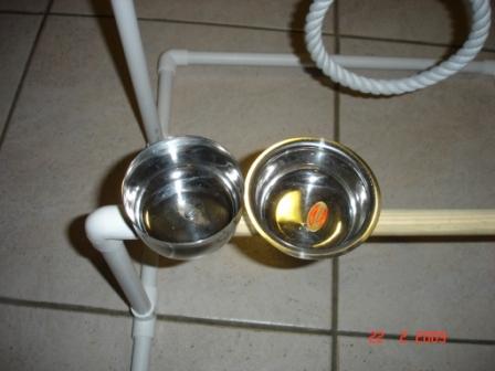

ranaz Posted March 24, 2009 Posted March 24, 2009 Sorry but I couldnt attach before, hope it works now The feeding bowl is screwed into the perch and then another bowl goes into it so I can remove and wash every time...<br><br>Post edited by: ranaz, at: 2009/03/24 11:00
