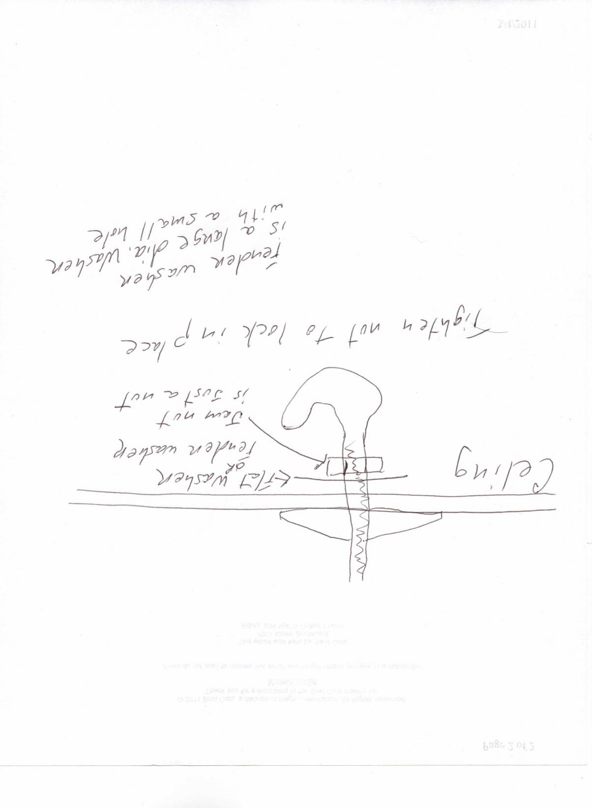

Ray P Posted March 6, 2011 Posted March 6, 2011 If you use a jam nut you could stop him from unscrewing the toggles
Luvparrots Posted March 7, 2011 Posted March 7, 2011 What is a jam nut????? What do they look like???
Ray P Posted March 7, 2011 Posted March 7, 2011 (edited) A jam nut is a nut that you screw on the bolt or bolt hook first than a flat washer or fender washer. When you tighten the toggle bolt to the height you want then you tighten the jam nut to lock it in place. I will draw a picture and post it Monday Edited March 7, 2011 by Ray P
judygram Posted March 7, 2011 Posted March 7, 2011 Its upside down but if I turn myself up on my head I can see it, LOL. They also make those ceiling protectors that rotate 360 degrees and keep your bird from going all the way to the ceiling where they can do damage, I included a link to one such item: http://www.greyfeathertoys.com/store/products.php?and=1&keywords=ceiling+protectors&search.x=11&search.y=6

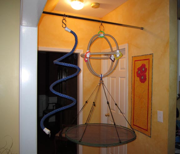

katana600 Posted March 19, 2011 Posted March 19, 2011 Great ideas everyone. Something else that worked for us is to put a shower curtain tension rod in the entrance of a small hallway. It is high enough above the door frame the bird can't reach the molding around the door. I was a able to find a stainless ring that slips over the rod to connect a boing and an "orbit" ring set filled with toys. There was a little screen seed catcher from the wild bird store that will connect to the orbit to catch wood chips and poo before it hits the floor for the dogs to "share". I will try to get a picture. The best part for me is that if we were going to move again, there are no holes to patch and paint. You might not have the right size hallway, but it might work in a doorway just as well, it just wouldn't be so high.
katana600 Posted March 20, 2011 Posted March 20, 2011 Everyone has different needs, this was just worked for me. It came from ideas on this forum to make toys. Someone had posted the general directions to make the orbit from lawn sprinkler tubing, plumbing junctions and jute. Some people use vet wrap.
