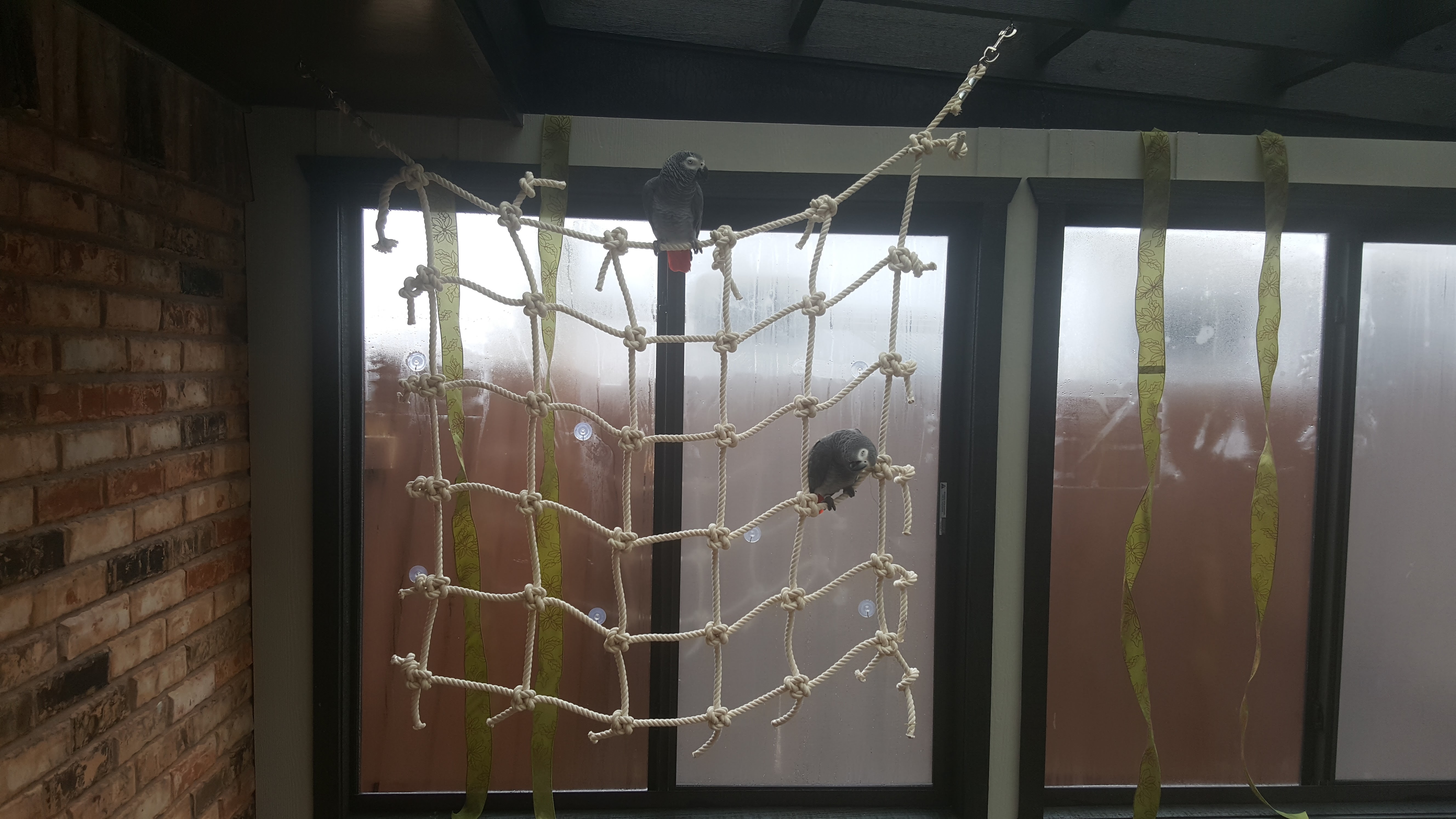

That was just the main construction.   I still have left to do:
Wire with electric - I'm getting an electrician to do that because it needs power from the panel and I don't screw with the panel.
Lighting - me and the electrician
Cameras with cat-5 cabling - me
Window wire panels - me
Some landscaping - me
More rope climbing nets and toys!  - me
