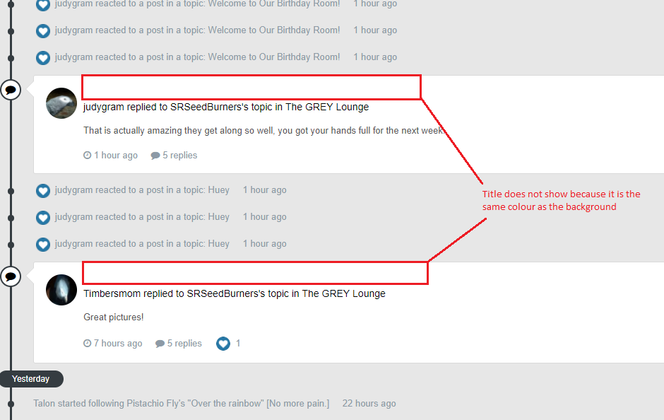

When I view the activity feed I cannot see the thread titles because the text colour is the same as the background colour. This means I often open up the same thread multiple times because I don't realise the posts are from the same thread.
So for example:
Huey
judygram replied to SRSeedBurners's topic in The GREY Lounge
That is actually amazing they get along so well, you got your hands full for the next week.
Looks like:
If there is any way to correct that, I'd be very grateful. :)
I'm not sure if this is an issue across all themes but it's definitely the case with the red theme for me.

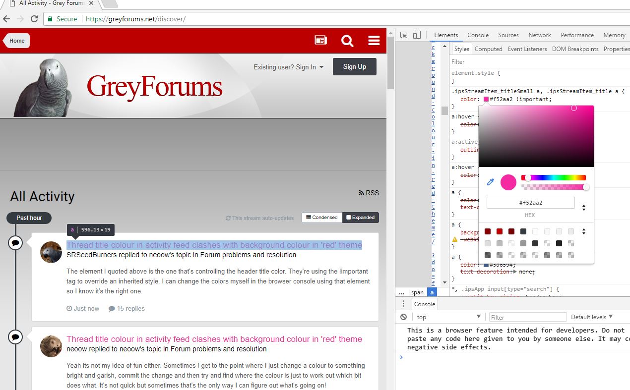

On 12/13/2017 at 2:39 AM, KevinD said:
I apologize, im sort of snowed in, ill take care of it when I get back
It's not urgent at all. I can deal with it. Just thought I'd give you a heads up. :)
Ok, I thought it was just the skin needed to be updated because I updated the base code.
Turns out this is a glitch in the skin. Ill have to turn it into the skin maker, and see if they can correct it.
If not, I can dig into the html code myself, but that will take some time.
These skin guys get paid well for a reason, css and html is a pain to pick through.
Im still out of town, but Ill look at it this weekend when I get back, the snow has cleared off the roads, I can drive back.
You folks in Ohio have it made, snow all the time LOL, however it does pose a problem when driving cross country..
  • Like 1
If anyone sees it let me know..... I got to pick through it LOL

This one is your huckleberry:
Quote
.ipsStreamItem_titleSmall a, .ipsStreamItem_title a {
  color: #fff !important;
If you change it to #2f262e, that matches somebirdy's neck feathers on the same page.  But I ain't saying who  xD
Edited by SRSeedBurners
Yeah its not my idea of fun either.
Sometimes I get to the point where I just change a colour to something bright and garish, commit the change and then try and find where the colour is just to work out which bit does what. It's not quick but sometimes that's the only way I can figure out what's going on! xD
The element I quoted above is the one that's controlling the header title color.   They're using the !important tag to override an inherited style.   I can change the colors myself in the browser console using that element so I know it's the right one.
Does Hot Pink suit this theme!
I changed it myself the same way, but when you alter the sheet, it doesn't work, There must be an overriding sheet, im looking for it, but so far, I cant find it. Thats why I hate CSS lol
There has to be a sheet with that exact element chain in it that is being used.  It's possible the themes have different style sheets with the same element styles - I've run into that.  I change what I think is the right style only to find it hiding in another theme's stylesheet using the same classes.   I'd do a global search on that 'ipsStreamItem_title' and 'ipsStreamItem_titleSmall' to see what sheets it pops up in.  The h2 tag is using both in the class listing.
