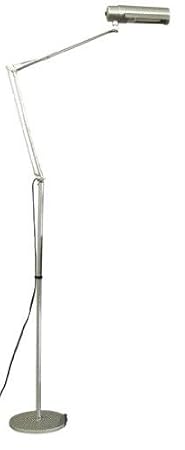

Please be careful with this light especially: AvianSun Deluxe Floor Lamp
I purchased one and positioned it just as it shows. MY tag got a very badly sunburned eye which which at first the vet thought was an eye infection. We treated her with eye drops for 2 weeks with no relief before I realized it was the light burning her eye. Once I removed it and tossed the entire light & bulb it in the trash, her eye cleared up in a few days. I previously used a different light that sits on the top of her cage, I went back to that with with no problems.

Use the new model, it is a much better stand. Place it directly over the cage as shown in the photo so it is 12 " above (On initial burn in place it 16 " away for the first 30 days)the top of your greys head when he is sitting on his favorite perching area. It will not create a burn or damage eyes. That only happens when people place them shining in from the side and too close to the birds face. Just follow the instructs that come with the avian sun lamp and all will work perfectly.

I use the Avian sun 5.0 bulb. The new stand should reach that high unless your talking about have the playtop model and your wanting to place the lamp 18 inches above the highest point of the play top. My cage is not a play top, it is a round top cage a little over 5 feet tall. When dayo is perched on his favorite spot, the lamp is 12 " from the top of his head because it has already burned in. When it was new, it easily adjusted to 18 " above his head.
